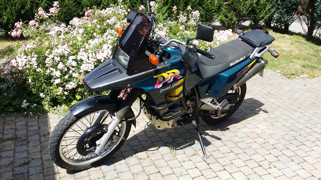

The colour of the bike was a dark metallic green and it was one of the last models made of the DR800 in 1997 before Suzuki gave up on the bike, although I did not like the colour and the bike had some problems (rotten exhaust and burning some oil) I managed to negotiate with the seller and get it for what I considered to be a very reasonable price (700 Euros), so I bought it!
Here is a picture of the bike on the day that I bought it

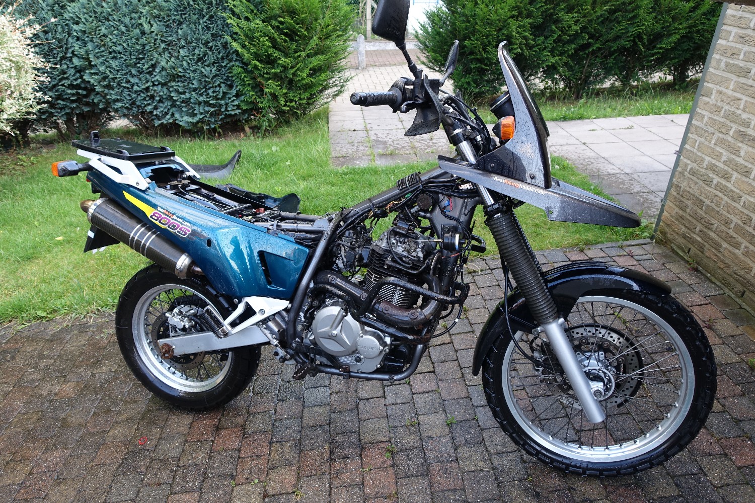

The first thing that I did when I got the bike home clean and inspect it.

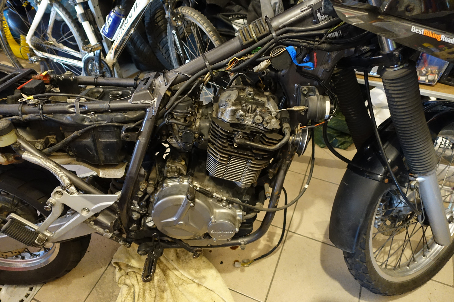

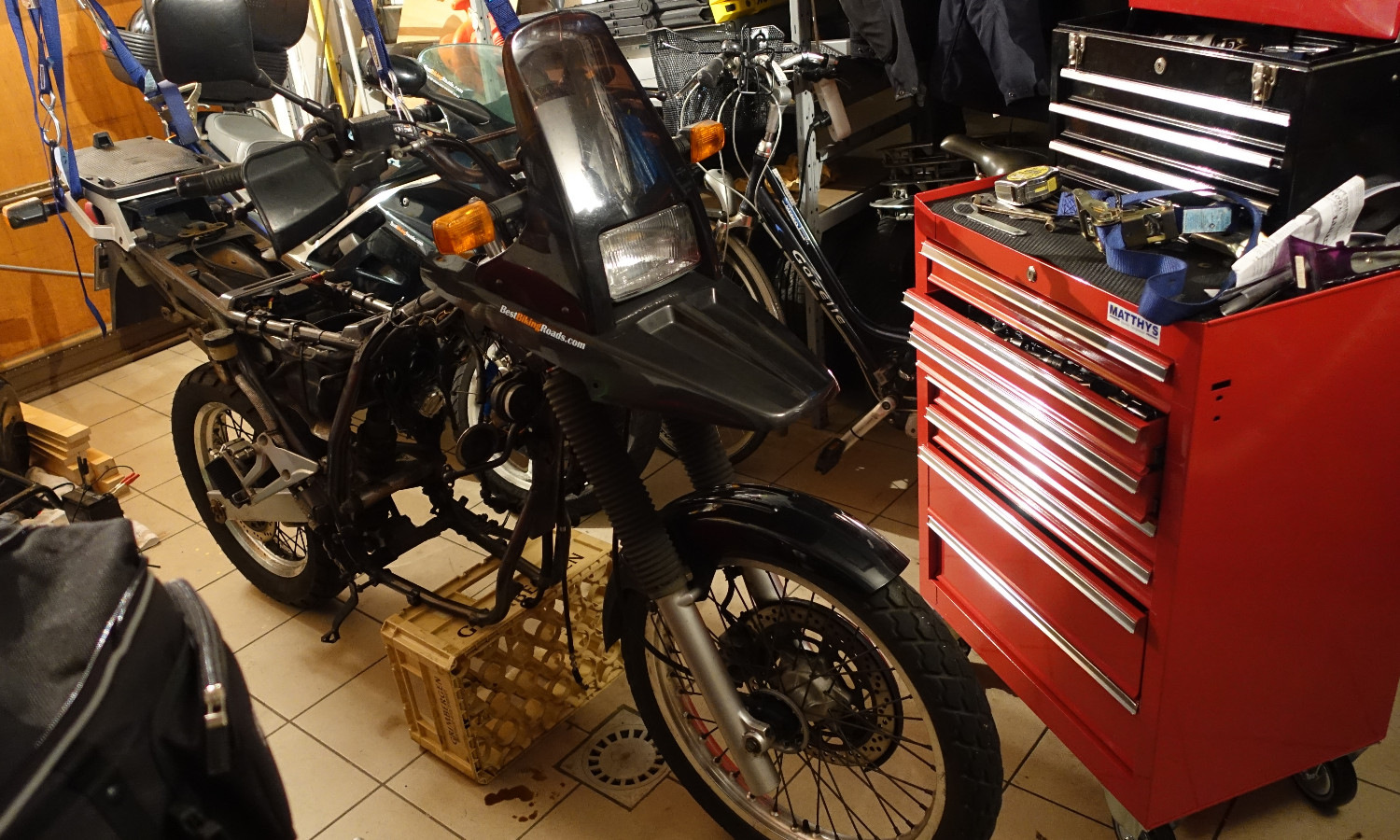

I wanted to start off by giving the bike a little service, I already knew when I bought the bike that it would need a new exhaust so I had order holeshot stainless steel one with a Sebring end can from Stefan Hessler in Germany but much to my surprise and horror when I removed the two spark plugs, one of them had small pieces of metal on it :(
This bike clearly needed at least the top end looking at
No problem I thought I'll simply take off the head and have a look, that shouldn't take long, sadly after looking at the workshop manual I learned that for this bike removing the cylinder head means first removing the engine from the frame :(
So that was the first step of what was quickly becoming a much larger project than I had anticipated.....
